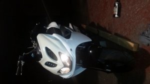

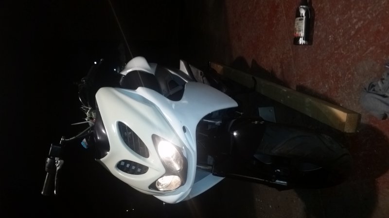

    Thankyou for your reply,yes apart from the 11 owners it has a jog r AC engine in it ,all the wiring was wrong & its amazing to see every owner has added their own liitle shortcuts.Bike was an absolute wreck when i got it but its nearly finished now thank god 20150926_013333.jpg 20150926_013333.jpg 20150926_013333.jpg
