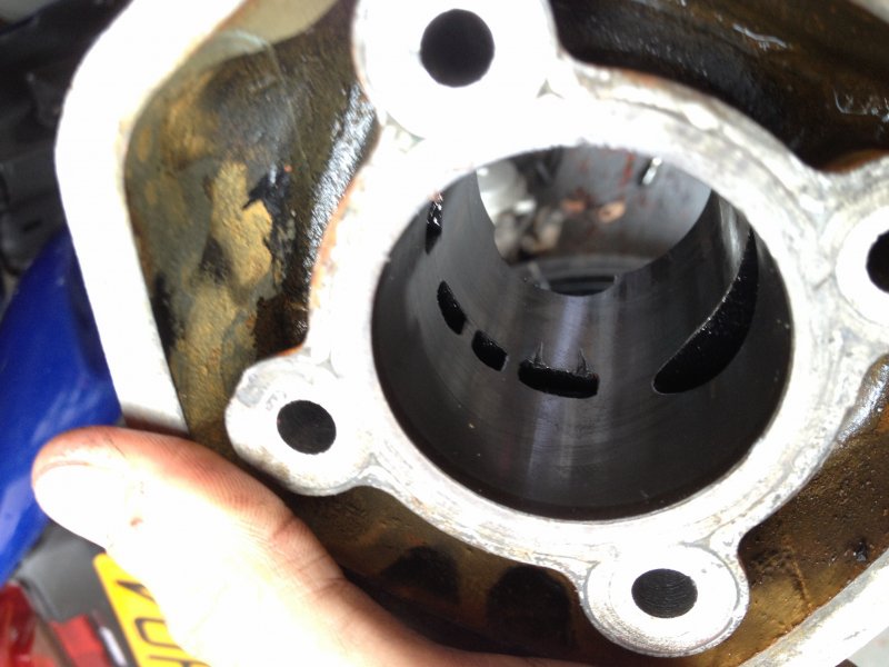

    Hi everybody I have just bought a 2004 seized aerox for £130 to fix up
    I have remover the full cylinder and piston and have realised I am going to have to change the 4 studs
    Three of the studs screwed out with the nut and one stayed in.
    I have ordered a stage 6 street race kit and 4 new studs
    Can anyone please help me on fitting the 4 studs because I have never had to do it and don't know if I just screw them in or have to measure them???
    Thanks for your help

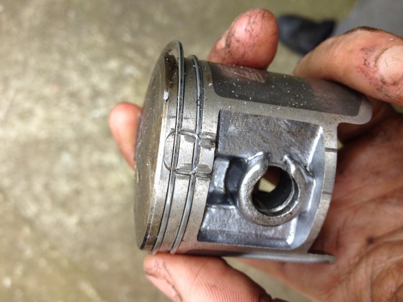

  3. Stevep
    if the lumps out and on the bench, try a pipe wrench. But dont force it as it might shear off. If the threads ok on it, then re-use it as normal. You can order the standard bolts as replacements.
    I see that you have a Naraku piston in your hand.
    Before you fit the new top end, chamfer the port edges in the barrel and any sharp edges on the piston, this will stop the rings snagging in the barrel and causing any premature damage.

    The reason the nakaru failed by the way is the piston clip. Is the crank ok? If it is, I would blast that engine, cylinder off, with 8 bars of compressed air in case there are any bits lurking in there. Or better still strip & rebuild. What crank does it have ?
