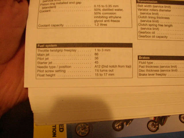

    The standard Aerox 50 main jet is 86 and the pilot screw setting is 1 and 3/8 turns out.

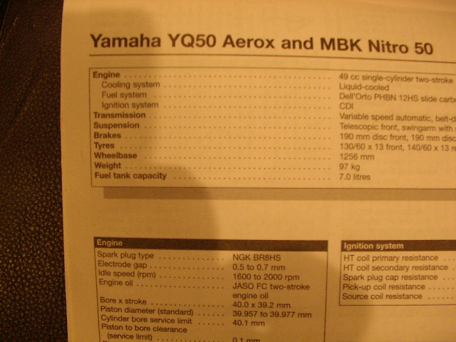

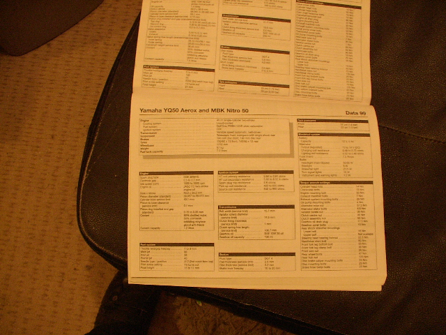

    in my data files, Aerox liquid cooled 50 should have a Dellorto PHBN 12HS slide carburettor, running a main jet of 86, pilot jet of 36 and a starter jet of 45.
    There is little logic relativity between makes of bike, you can get two different makes who use the same engine and same size carb, yet the jet sizes will be different.

    Highly doubt that the standard main jet is 86, so had a look on google and found a link says its 62. What performance exhaust have u got ? if u have a high end 70 exhaust it will make ur bike run like shit on a standard 50.

    well all I can say is that was my source. Be interested to see yours.
  10. GUNS
    GUNS the usual suspect
    519
    racing SP70 & LX172
