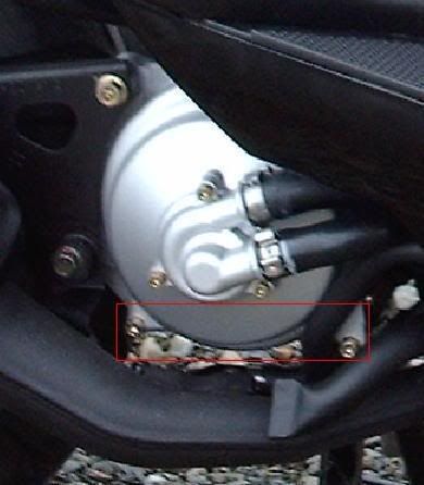

    ther has been a leak from underneath the water pump housing.
    the leak has been coming from undernath the housing. marked red square
    the leak isn't tht bad just a few drips every now and again...
    can i just undo the allen keys holding the housing on, then use gasket paste/sealant then bolt it bak on and the leak should stop?
    thanks fuj..!

    therte is no gasket, i would immagine that its from rain or washing the bike.
    does your water level go down? if so then remove the water pump and replace the gaskets (abaout 20 min job on an aerox).

    yep it was low on water so i topped it up. gasket sealant might do the trick though...
  7. wobbly_trials
    yeah it might also get into the water passages, just get a waterpump kit, its not THAT expensive and it guarantees that you won't overheat it.
