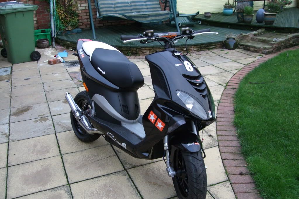

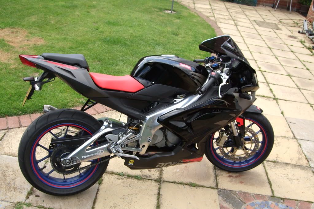

    Heres my old NRG and RS
    If anyones interested :p
