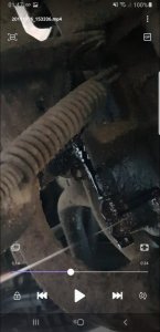

I have a malagutti f12r phantom and wen i put 2 stroke in, it just leaks straight through the casing underneath the bike i have a video if anyone can help
Either The oil pump itself is leaking or more likely the rubber pipe that feeds it is split. its not uncommon on those as it contacts the casings in a few places
Going to take the water pump off today to get to the leak behind it to check the oil pipes cheers guys

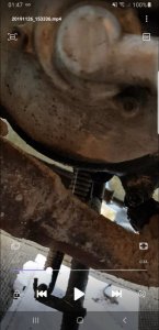

It is literally comin from the compartment behind the water pump but underneath and theres a slight gap between the casing almost as if there should be a gasket or some sort of gasket paste there but the water pump 5mm hex heads are threaded so having a bit of trouble gettin into the water pump
That is where the oil pump is located and if you mean the gap on the water pump drive casing it’s not a air tight seal/fit. It just houses the water pump drive wheel the gap is how it should be.. once you have that off and then the fly wheel you’ll get to your leak. You will need a fly wheel puller
