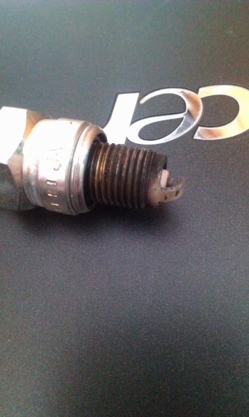

    this is the condition of my spark plug am i right in thinking its running a bit lean ? IMAG0030.jpg

  3. Iggy13
    Iggy13 Member
    118
    Does look a bit lean
  4. ramo
    ramo GoldMember
    1,571
    Yeah I'd say so
  5. Mark Emerson Trentham
    Black/tan/mild grey should be o.k. .
  6. 748-tone
    748-tone Member
    51
    ducati 748 - SR50R
    Thats a little lean always take your colour off the centre probe
    But thats how 4t are restricted smaller jet ( if yours is std)

    549
