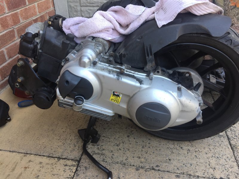

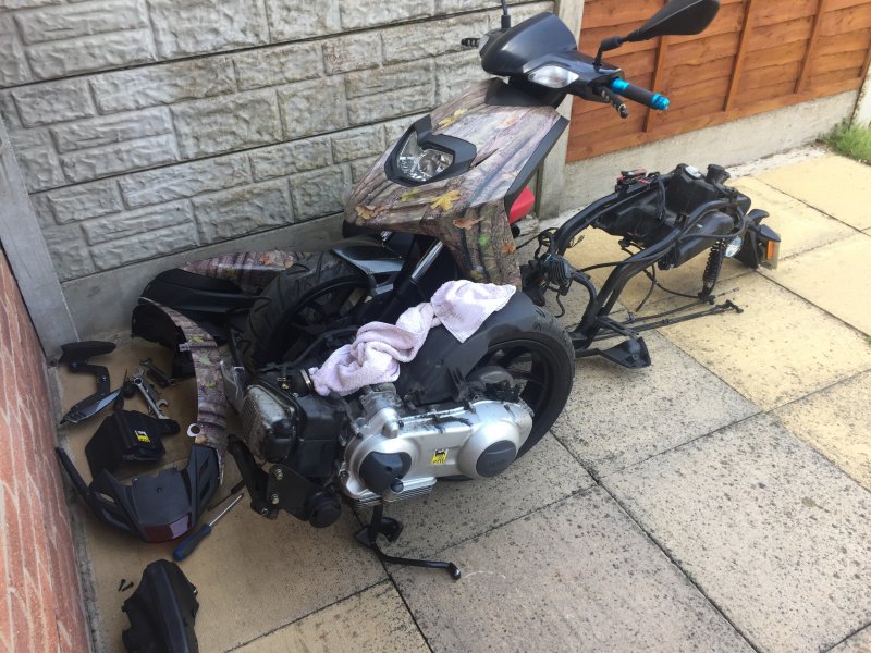

Todays job get the engine out, going to have a little look inside tomorrow if i cant see an easy fix ill just replace the whole engine, and sell this engine as spares or repair. Saves time and effort.
