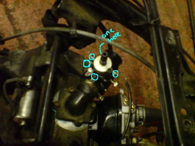

    what goes where ? lol a bit confused
    cheers
    ben.
  2. nrgandy
    one near inlet is the vacume and the 2 on ether side are over flows. The small thin one is oviously oil and the big oe to the backs fuel

    Yup. Hurstly if you can do it and you fancy a ride to coulsdon ill happily do it for you.

    If this helps, the coolant does not run through this carb. Like andy said, two silver down facing pipes at sides are overflows and dont need to be connected to anything.
    Little gold one sticking out side is oil.
    One by the inlet manifold is vaccum.
    And big gold one is petrol.
    Top is ibously throttle cable and one next to that is choke.
    Nothing else needs to be connected there is no connection for water ect lol.

    ok cheers guys.. on my standard carb liquid ran through it
    also.. how can i make the oil hose longer without taking it off the oil pump ??

    go to a motor factors and look for an appropriate sized connector to add a piece of pipe to the oil line...
    or pull the brass nipple/connector off an old carb and use that ;)

    nono i need to extend the oil hose its too short

    Clamp the oil tank feed hose, get a new length of same bore hose for the carb oil feed, use long nosed pliers and pull the original out. Pop the new hose end into a boiling cup of water for a few minutes to make it soft, shake dry (ensure no water remains) and then use the pliers to slide the new hose straight back onto the pump outlet.

    so i can do this by just taking the cover off the front of the waterpump ?
