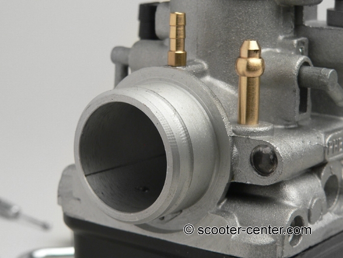

    Do I do exactly where polini has there's on the picture below polini caaRb.jpg

    me personally would get the polini one as it all ready has the vac and oil feed installed , no matter what carb you buy you are going to need to set it up so buy a selection of jets as well i think they are a 5mm main jet for the 25mm carbs

    Gilera Runner SP 180
