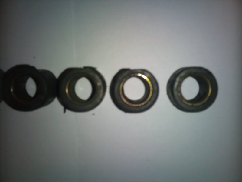

    These have come out of a Peugeot v-clic, 50cc, 4 stroke, 61 plated, completely standard and NOT MODIFIED IN ANY WAY. I have just replaced the variator with a complete and full new one; the first photos are the rollers supplied with the variator assembly. They have done just 472km and look at the state of them.

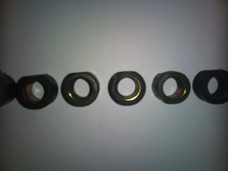

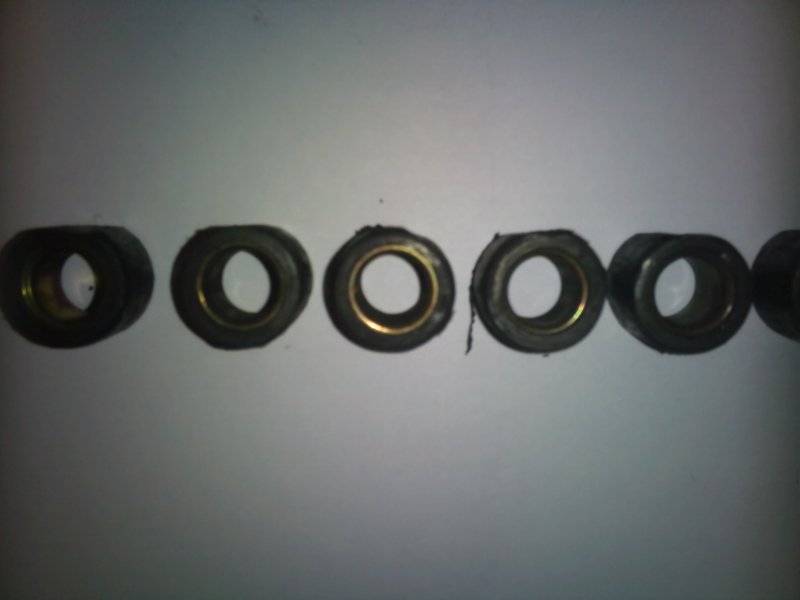

    The second set of photos are the replacements that were fitted so i could get my customer going again. They have done the grand distance of 166km.
    As well as replacing the variator assembly and rollers, i also replaced the drive belt; i have tonight had to change that as well because it stripped, probably, i'm thinking, due to the rollers not working correctly.
    This is the set that was supplied with the variator assembly: 472km

    This is the replacement set: 166km

    Are those rollers Peugeot OEM ones, Steve? The V-Click is a Peugeot-badged Chinese-built scooter as far as I know and the quality shows.

    Are those rollers Peugeot OEM ones, Steve? The V-Click is a Peugeot-badged Chinese-built scooter as far as I know and the quality shows.[/quote]
    You're right about the peugeot badged thing, its actually made by a company called Jinan Quinqi in china, they are chinas 20th biggest scooter and electric scooter manufacturer. It's actually a re-badged Sinnis Jet 50. And yeah, the variator and rollers are OEM, brand new for under £20. As you say, quality.
    But when the kids parents are on a budget you do what you can to keep the price low for them, so far i haven't charged them for the replacement rollers or belt because they are going back to my supplier. He is most interested to see the damage on them.
